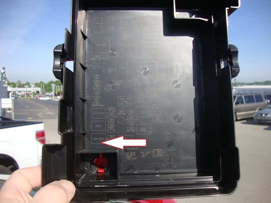

The underside of the fuse box cover has a diagram to show you what each fuse and relay is for.
Close up view
I like to lay the pulled relay in the cover, and leave it on the floorboard of the car. This way the mechanic can't miss it.
